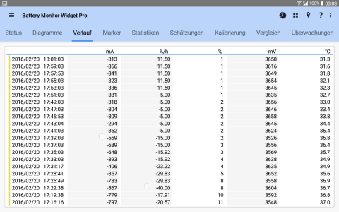

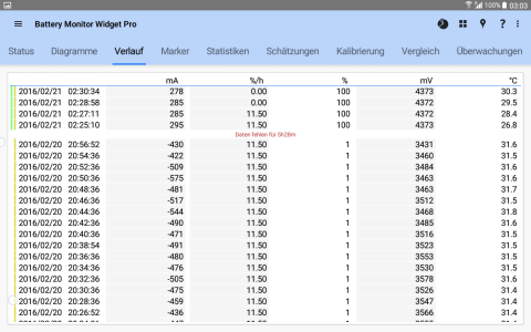

I see, that after installing a <Battery Monitor Widget Pro> i have recorded long logfile. Entries are sampled every 2 minutes. And result? I present here 2 screenshots of the logfile:
- first the point, on which the tablet begin show 1% accu charge. This was 17:51 MET.
- the second is the point, on which the tablett does self shutdown. This is 20:56.
In this whole time the tablet has played live videostream from my satellite receiver by full loudness! WiFi, GPS and Bluetooth and telephone card are always on. Streaming of the video was done over WiFi. On the pictures you can see, that under this circumstances 1% charge are displayed for 185 minutes. Over 3 hours by fully working tablet - only the brightness was turned down, but even for this reason i had activated streaming video and all the other components to increase current like by full brightness. 3 hours and still 1% ??? Wha of **** may be this?
How can i linearize this extremely bad percentage curve of accu charge??? It is terrible - so i cannot controll the rest of my charge and plane the work on this tablet. The tablet beginns with current savings, althrough it has for more then 3 hours time to live?
