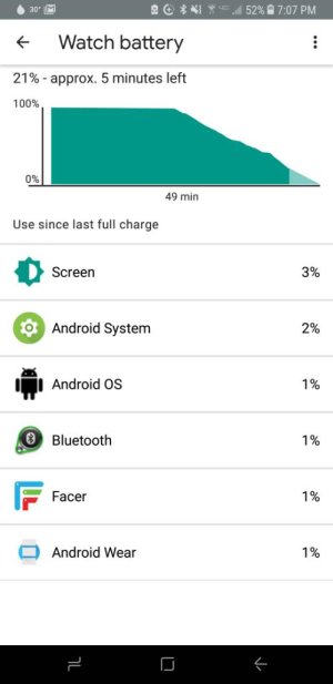

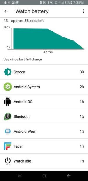

What the hell is going on?
I just turned on my watch and the battery literally dropped like a rock right before my eyes?!?!?!Screenshot_20180315-190751.jpgScreenshot_20180315-190900.jpg
I can only think of two reasons this happens. Either the battery has a slight short in it drawing it down (though this usually happens much quicker), or it's been worn out to the point it has little capacity left.
In either case, my guess is it needs the battery replaced.
Maybe it was because I was downloading a bunch of apps to it at once?
In the most demanding use, that should still give you a couple hours hard use on even a half decent battery. If you drained the entire battery in a half hour or less, that's almost certainly a bad one. Doing a lot of work on the device will drain it quicker, but shouldn't be that bad.
