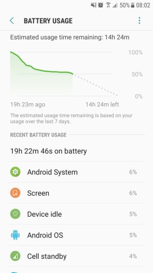

Here is a quick update from me.
Light use yesterday, 2 mail accounts on sync, wifi and gps on, screen on auto, high performance mode with no offset on display brightness. About 1.5 hour of screen on time.
It seems that, when used, it will drain battery faster than on marshmallow. During writing this post 3%battery gone :-)
