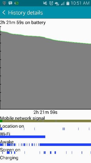

I can't seem to figure out why this battery is draining so fast it's awful I have to charge it three times a day...it drains two percent every ten minutes or so..it's brutal...I'm not even using it..it sits on my desk all day at work except to check texts and what not...anyone have an idea why this is happening..it's a brand new unlocked ATT phone...only two weeks in...I don't get why it's happening and it's aggravating...any help appreciated...thank you

Have you looked at what apps are using battery? There's a lot of "awake" time going on there, particularly with WiFi off.

Right off the bat as natehoy says the screen shot depicts an issue with an application or service running constantly in the background (as evident by the awake bar being solid blue while the screen bar shows screen is off at times). Your signal strength is also marginal most of the time. Couple the two issues and its no wonder that battery life is poor.
Look at the battery stats pages more closely and examine what applications rank near the top. It also may not hurt to reboot into recovery and clear cache.

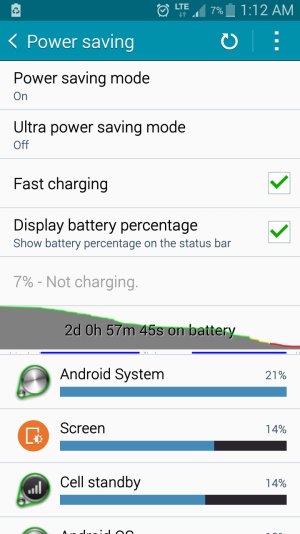

You tell me what's running in the background at a high percentage because besides Android system I don't see anything other than that causing the battery to drain...it's awful
i notice that you have blackberry app i removed mine right away i notice how much battery it's draining. What's the one right next too it?
I would do a cache clear first by rebooting into recovery (turn the phone off, pull the battery for a few seconds to be sure, replace the battery, hold HOME & VOLUME UP while depressing POWER until the boot screen comes up and releasing POWER while holding the other two a little longer). I'd then let the device boot up, leave it untouched for a half hour and return to the battery stats graph screen to see if the awake bar is still solid blue for the period that the screen is off. If it is then start uninstalling unnecessary utility applications and widgets systematically starting with any memory management, cleaning or battery monitoring apps.

Actually you don't get great reception, the mobile network signal bar on the attached image in your first post proves it since there's a short bit of green initially and then 95% of the time the bar is mustard colored. That color designation means lower signal, red means no signal.
It is best to start logically and systematically to figure out what the issue is. The long wake times is the key right now so try to start there first by clearing cache and testing for wake time. If the device goes to deep sleep after a cache clearing (in recovery, not using some random play store app to do it) then you're golden but if not then move on to the next thing such as pulling the microSD card and retesting . . . after that, try uninstalling utilities.

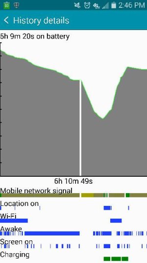

It's not the SD card it's brand new...128gb memory card...IDK why there's so much wake time and I get good reception mainly everywhere I go...I don't care what some color bars tell me about my reception seriously...

The gap would indicate you rebooted, and it looks like it helped. I agree with the cache clear in recovery.
