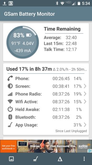

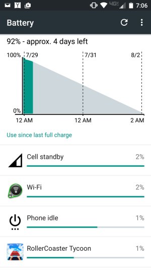

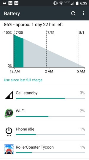

I have attached a few screen shots of battery usage, 2 of them being over night and one just throughout the day. The common theme seems to be that Cell Stand By is the biggest culprit. This was never my biggest user prior to Lollipop. I realize with the one that Roller Coaster Tycoon is a big one but I was playing that while on Kit Kat and never saw this kind of drain. There is also the issue of Caller ID draining the battery which I don't fully understand since I opted out of that after that free trial period Verizon gave.

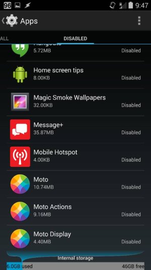

I don't usually post, but I've been fighting with this since lollipop and as of this morning, about 12 hours after I made the change, all seems good. I have not seen this tip elsewhere:
WIFI->Menu button top right corner to open advanced->disable "Scanning always available" disable "keep wifi on during sleep"

How did you do this?

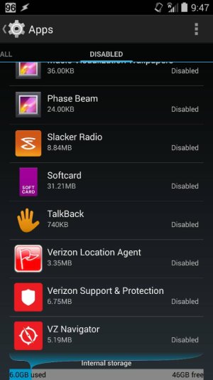

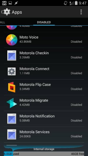

Here's a screen shot of the moto stuff I disabled.

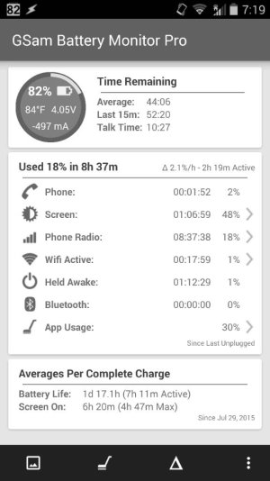

And here's a screen shot of today's battery use so far. Been working outside all day so the actual screen time is low. But this is average use for me.

Sorry forgot to attach it.
Our batteries seem to be very similar. You've got over an hour of screen time; I've got 38 minutes. You've got only a bit under 2 minutes of cell phone use, I've got almost 27 minutes.
Off charger for 24 hours with nearly 3.5 hours screen on and still at 50%......I'd call that pretty good battery life.
Yes, it is, BUT it's not as good as it was on Kit Kat. I'd have to go back and look at screen shots I took of my battery monitor on Kit Kat, but I'd guess with this same sort of usage I'd have 65% remaining.
