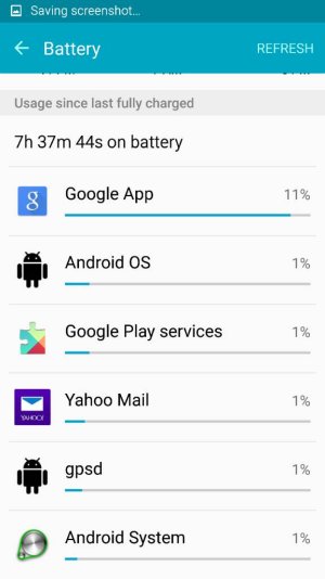

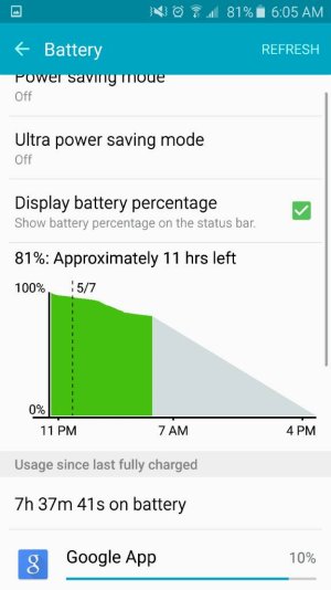

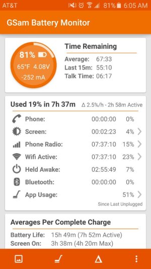

19% drop and I can't really figure why. Can anyone help?

yeah but I have followed all of the reccomendations, shut down, uninstalled or disabled all that I could.
Only thing that i dont shut down is location as I dont like to have to toggle it back on when I need it. When I first got phone it was draining 8% or so overnight. It has more than doubled

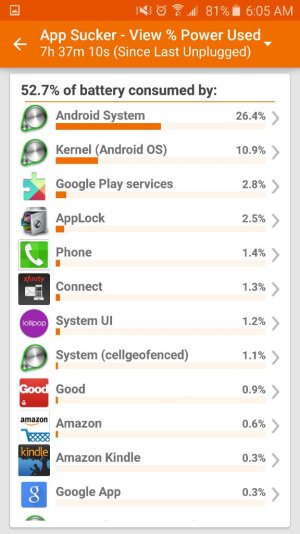

I see a similar pattern of %'s used by Android System and Kernel using the same battery monitor app as you. Not sure if those levels are normal. I do find standby drain is a negative for the S6, although it does dependably get me all the way through a day so I'm not concerned about it. I'm assuming Android updates will improve the standby performance.
19% is kind of massive. I slept for roughly 7 hours and lost 1% per hour which is kind-of decent I'd say. I turned off all my syncing besides email, that could definitely impact it.
