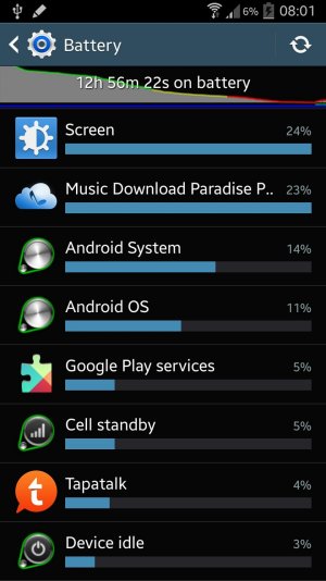

Hello all, First time poster and i really need help please.
I bought a Note 3 two weeks ago and the battery drain is so bad. I am lucky to get 8 hours out of the battery. Can anyone please help me - I have attached a screen shot below.

Try disabling or removing whatever that music download app is (second on list). Once it's removed or disabled, reboot your phone, recharge to full power and monitor again. It looks to me like that app is the culprit.

You need to leave it a while, preferably a full battery discharge/charge cycle to get any meaningful figures from your monitoring app.

Ah ok, well since i delted that app anyways it even seems to be charging faster....it was a handy app to have tho :'( as you could download all MP3....any suggestions for a new one :)
