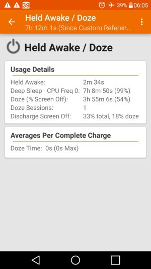

Hi,
I have a strange problem that surfaced after the Marshmallow update. I normally switch my phone into Airplane mode overnight so that I'm not disturbed. Prior to the update the battery would have drained 2-3% by morning, whereas now it drains 30-35% overnight. I have installed GSam and from the screenshot you can see that in the 7h 12mins since the phone was unplugged the battery has drained by 34%, and for 4 of those hours the phone was in Doze (accounting for about 15% of the 34% drain).
How can my battery drain by 15% while in Doze and in Airplane mode? There doesn't seem to be any rogue app in the list, and the phone has only been kept awake 2m 34secs out of the 7 hours. Any help gratefully received.

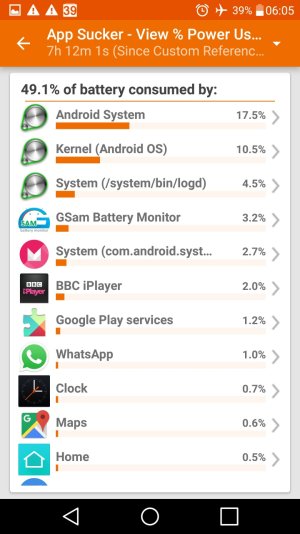

Doesn't appear to be a rogue app but there does appear to be a rogue service inside Android OS causing you problems.
If it's an Android OS issue then am I right in thinking a factory reset won't help?

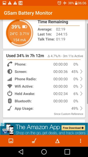

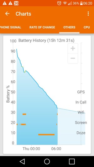

One thing I've noticed from the stats (bottom left) is that the screen has been on for 36 seconds yet is responsible for 45% of the battery drain. This doesn't match at all with the chart which shows a steady discharge over 7 hours. If that 45% was correct I'd expect to see a massive step in the chart where the screen on time is.
Could my battery be knackered?
