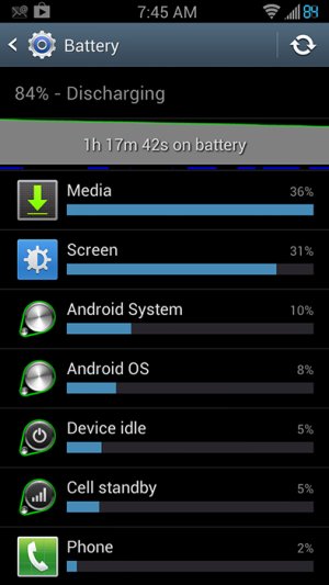

I have a custom rom but I have not made a change to it or anything else on my Note 2. Lately, the battery is draining rapidly. Last night I charged the battery 100%, used an app to calibrate it, drained it completely, and then charged it overnight with the phone off. I turned it back on and ddid not use it at all, except for 3 emails that came to the phone, but it is still draining more than I like - down to 84% (from 100) in 1 hr 17 min. I looked at battery in setting and it says media is taking up 36%. When I looked at this yesterday media wasn't even present. Again, all I did was turn on the phone - I did not start any apps.
Any ideas?

Media is what's doing it. My mate had this problem. Pull the sd card if you have one. If it's that it will be a corrupt file causing the issue. Your phone will constantly be trying to open a the file on the sd card. Thats why media is present.

I have the exact same problem with the media app. It is using 85% of the battery all the time. My sd card also says it's blank or has an unknown file system sometimes and 10 minutes later it's working fine. I think that the SD card is being mounted and unmounted a whole lot of times when I'm not using it, draining the battery.
I'm sending my sd card back into SanDisk and they are replacing it for me today.

That will be the problem. Could try a format maybe

I have formatted with the phone. And I have formatted with 2 different computers to NTFS, FAT32, and exFAT32. NTFS was the worst if I remember correctly. I think it was unmounting and then mounting, and the media app was scanning the card for new data every time, killing my battery. I start off with a 100% charge every morning and by noon I am down to 40-50%. So, 4 days ago I started the RMA process with SanDisk (which is very easy).
Yesterday, I did not see the Blank Disk message or any error messages at all all day, and none today before I removed it. Seems like it was working for the first time in a month, but I don't know.

It's the SanDisk card. Newer Samsung phones (Note 2, Galaxy S3, etc.) have an issue with SanDisk cards (especially 32GB ones) manufactured before December 2012. They work fine for a while but then start mounting/unmounting themselves and in some cases, result in actual damage to the card, rendering your files unusable. SanDisk claims all their cards manufactured on 2013 don't have this issue.
I'd still play it safe and get a Samsung card or a (much cheaper) A-Data one which, in turn, has Samsung-provided innards.

MOST SanDisk cards made prior to December 2012. It doesn't happen at first, for some it doesn't happen at all... For most, it happens at some point and can cause you to lose your data. SanDisk is aware of the issue and as long as you mention you have a new Sammy phone and purchased one of their cards and it was made before 2013 (I think the only way to know is look at the packaging), they will issue an RMA and replace the card with a new one.
