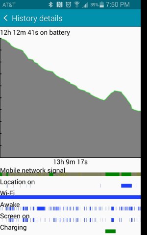

Well, this is about the most detailed info I can give. I used the phone pretty heavily at work and charged it a little bit after work before I went with a walk with the S Health thing running (hence why location is activated towards the end.)
So, it's now at 39% after a whole day of fairly heavy use and a little charging. It would probably be more like 15-20% if I hadn't charged at all.
