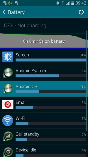

Post a screen shot of your battery Stat page and I'm sure people will tell you what is causing your battery to drain.
I can't seem to figure out what it is at all

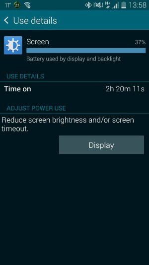

Well this is what my screen usage is like this is over 13 hours and my battery is down to 22%.
I will be taking everyone's advise but compared to an iPhone this is horrendous

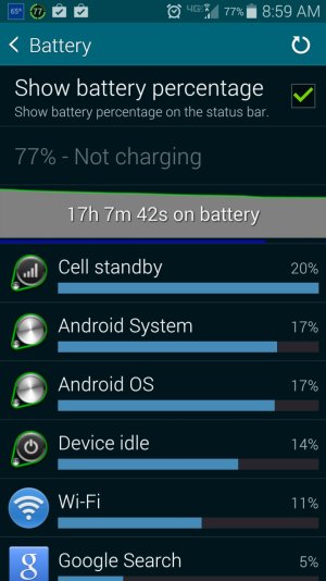

Here is my current screenshot as of this morning.
