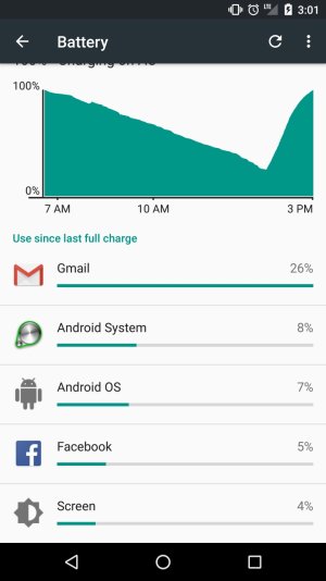

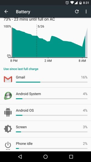

Recently my battery begin dying very quickly. Light use during the day would have my battery depleted by the end of the work day. Do you have any ideas on settings that may need to be changed? I have cleared the phones cache but have not had any luck.

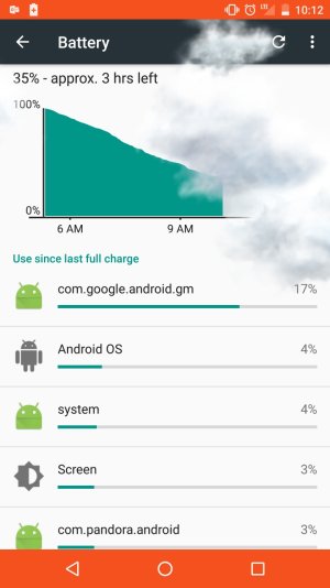

I am also having the same issue, i usually have between 30%-40% left at the end of a 12 hour work day, but since yesterday i have run out before the end of the day. Gmail also seems to be the issue for me.

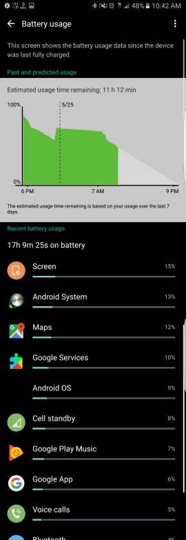

Not seeing an issue on my S7 Edge. Screenshot below of the version I am on so you can compare.

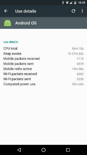

Any ideas of what is keeping my phone awake? I'm sick of this terrible battery life. I have location turned off and Google now off. I've also deleted about 12 apps.
