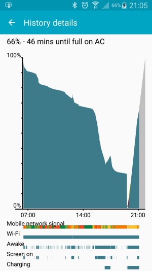

So I had 23% battery life on the Note 4, opened the camera app and started recording a video and the phone flat lined in around 3 seconds. Anyone else had similar occurrences?

Battery percentage remaining is based on voltage. The trouble with Lithium voltage is that the voltage is high and rapidly decreasing for the first 20% of discharge, medium and pretty steady for the next 60% of discharge, and drops off rapidly for the final 20%.
Probably running something that uses the screen, camera, and continuous writes to memory (all of which consume battery) on the edge of the voltage drop cliff artificially dropped the voltage and "fooled" the phone into thinking the battery was nearing discharge, or actually drained the remaining power very quickly.
How long have you had that battery?

That curve is typical of a battery growing a dendrite. (See Lithium Battery Dendrite links to learn what that's all about.) There's nothing you can do but replace the battery. Most carriers won''t cover it under warranty if the phone isn't within the exchange period (normally about 2 weeks), but you can ask - it's - as you can see from the links - a very well-known problem.
Natehoy, see figure 2 at Lithium-based Batteries Information – Battery University It's not true. The voltage drops pretty smoothly from a full charge. (Pulling the plug the moment the phone says "100%" isn't a full charge - with a battery in the 2000mAh-4000mAh range, you should give it another 30 minutes.)

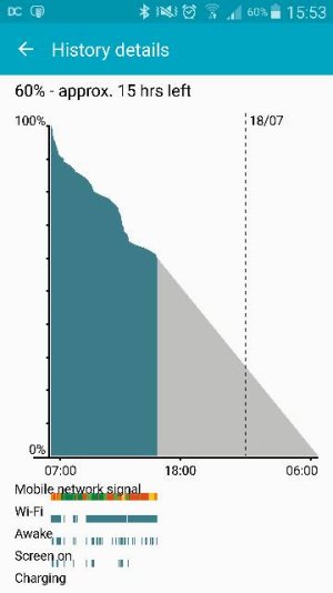

So far so good. Will definitely invest in the spare batteries. Hopefully I can get that deal here in the UK. Phone was unplugged today at 630am and now 4pm with 60 odd percent left and looking more reasonable. A new battery may extend this further and I'll likely update again when I get the new battery. I'm noticing a lot of waking when the phone is in pocket or not being used so will have to use a wake lock detector to figure out what's doing that. Apparently that's fun when not rooted on lollipop but nvm -.- also no noticeable bulge in the battery.

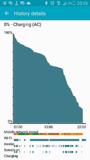

Did it again :O this time it was sat on the side. Can anyone vouch for the 4500mah 3rd party batteries available for note 4? Kinda interested but will probably stay OEM.
I notice on your screen grabs that you seem to have a really poor mobile network signal.
There are many posts on this forum from people much more knowledgeable than I, who say that a poor mobile network signal is a huge cause of battery drain.
Posted via the Android Central App on my Note 4
It is, but I don't see a clear relationship between weak signal and the steeper drops in battery, plus the battery simply should not drop from 20% to 0% like that.

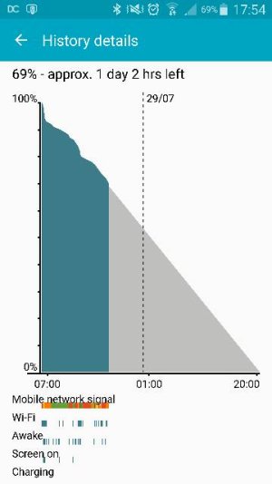

So... Same battery then this happens... Do... Not... Understand ... This... Phone lol
