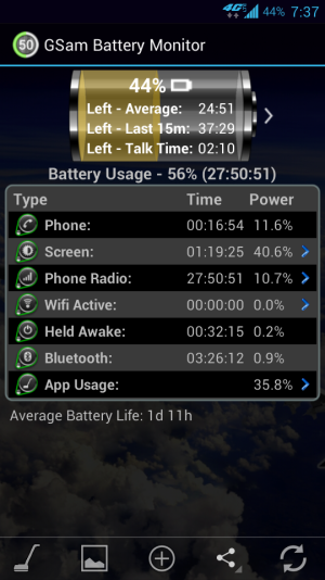

OK the JB upgrade is fantastic. LOVE Google Now and can't wait to have it for an extended period of time. Only beef is my battery time is down about 40%. I used to be able to get through the day w/ moderate use and be on 40-50% when I plug it back in. Now, I'm generally at 20-10% and noticed the Android OS is the main culprit. How can I limit this?? My screen should be the culprit of taking up most battery use and Android OS and System should ideally be under 10%.
Any ideas/suggestions would be awesome.
Thanks!

I've been running JB since the Dec. 24 OTA "leak" and haven't had any battery issues until just this past week. I can't pin point exactly when it began, but I would say Saturday or Sunday battery started dropping fast. Normally, I charge overnight and charge again around lunch time. Yesterday, I got to work and the battery was below 40% and was BURNING UP! Actually, so hot, that the temperature warning was triggered and I turned the phone off.
It's been reported in the Maxx forum that going into Map settings & disabling Location Reporting makes a significant improvement.
Thank you again. It looks like we have a winner!
I disabled Location Reporting. My phone has been off the charger for about 4 hours. The battery is 90 degrees and I have 75% left.
