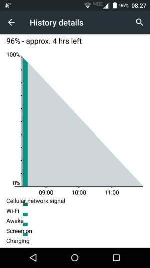

Can someone please explain to me why and how just after I unplug my phone, it's telling me I'll have only 4 hours of use?! This is getting ridiculous!uploadfromtaptalk1455456515947.jpg
That's not even close to typical. You either have a bad device or an app that is draining your phone. What steps have you taken as far as trouble shooting?

Your screen was on the whole 10 minutes right? Losing 4% with the screen on for minutes straight isn't totally surprising. Depends on the brightness too. At that point the 4 hours remaining would be extrapolated based on just those 10 minutes where the screen was on the whole time. You should be able to get more than 4 hours SOT so it's not good, but I don't think it's quite as bad as you're making it out to be.

Just what beeare said. That graph is based on your current usage. Set it down a while and it'll change.
