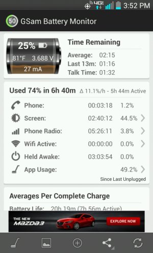

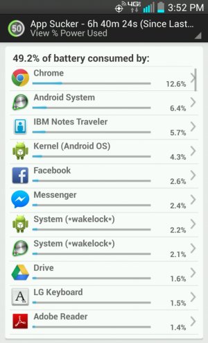

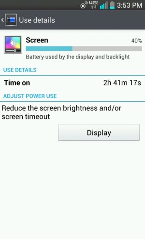

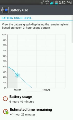

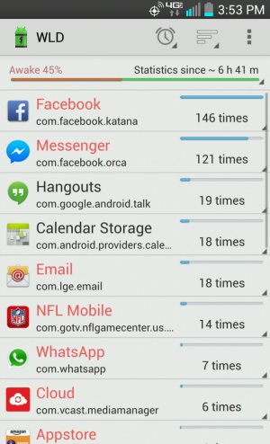

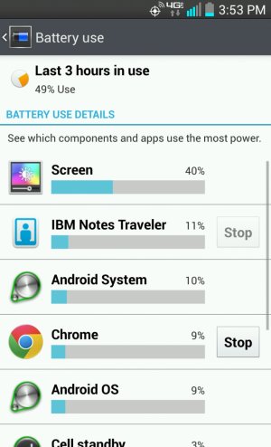

I've been biding my time with my phone. I used to get ~20-22 hrs life on a charge - not quite the 2-3 days some people post about, but it was ok for my purposes. Lately though my battery life has plummeted. I'd really rather not factory reset, although it is looking more and more likely that will be the case. I am on a stock launch day LG G2 (never before rooted). Here are some screenshots:
Edit - also halfway during the day, the phone was in airplane mode for 1 hr, so nothing should have theoretically been transmitting during this period.
Anecdotally, whenever I browse the web on my phone, the back becomes very warm or hot. Not sure why this is.
Brightness is set to autobrightness (55% baseline). GPS/bluetooth/wifi off unless I am using it (have not used it once today).
Any tips? Thanks!
