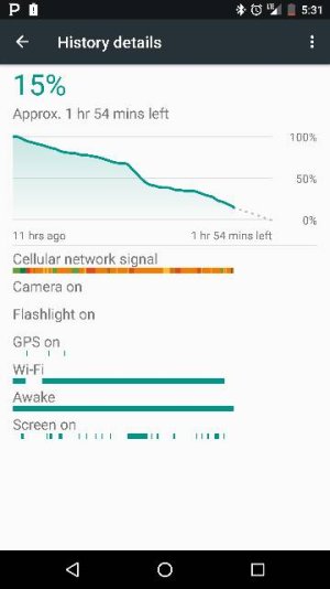

New nexus 6p owner here, switched from iphone 6s. I had used the Galaxy S5 when it was new and jumped back to iPhone due to att updating & bugs.
Nevertheless, loving the phones software and interface. My only concern is battery life.... Is this normal for the 6p, or is my low service really talking a toll?
Verizon service is 0 to 3 bars here in the office and I'm also connected to WiFi (no WiFi calling with Verizon) and I'm going home each day with around 20% and maybe 2.5h Screen on time. Normal use consists of browsing web, texting, YouTube... No gaming.
I know iPhones rock in standby, but my question is: is this normal for Android and the 6p? And if I were to switch carriers, how much do you think it would increase my battery life?
I really don't like the idea of having to babysit all the settings all the time & tweaking it to nothing in order to make it though a day. Any thoughts or suggestions? Thanks so much!

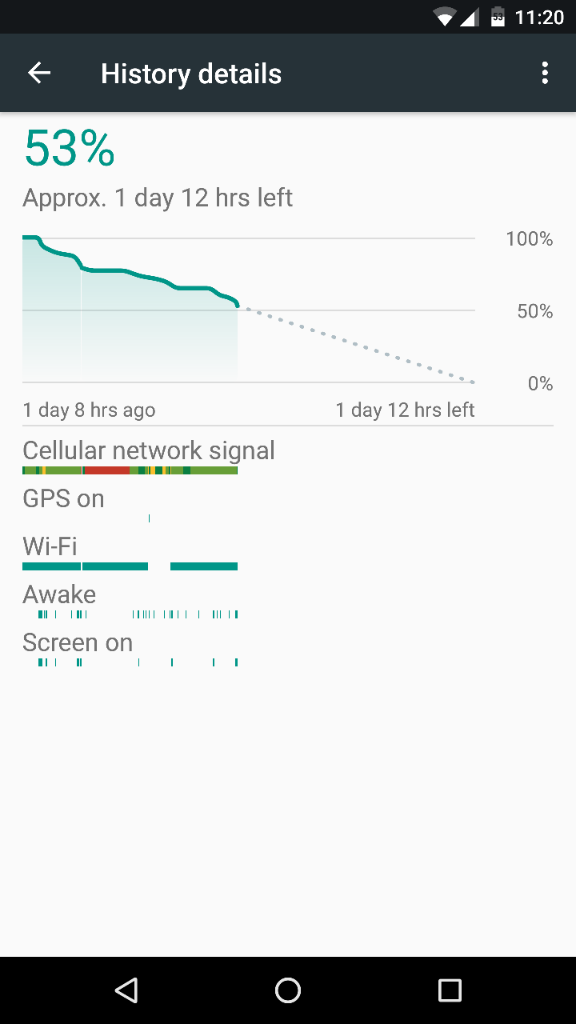

If your signal is bad, in the battery graph it shows as red, or black, then yes it will kill your battery just like that.
Attached is the details. Do you think this plays a pretty big factor in my drain? For instance If i switch carriers to someone who offers better service or wifi calling, what percentage do you think it would improve my battery life? Just in your opinion.

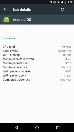

It has nothing to do with the signal - your phone simply isn't sleeping - likely due to the wifi/bluetooth wakelock issues many are experiencing with Nougat. Check out your Android OS in your battery stats and there is no doubt that your "keep awake" is likely through the roof. You can see from the picture you posted that the phone is not sleeping when the screen is off. This is due to the wakelocks
Ummmm no. Bad signal will torch a battery. I mean the wakelock thing doesn't help either, but bad signal is just as bad. He could turn the radio off, and use Wi-Fi. That might help.
I agree with jlukes, one look at your screenshot and it's obvious where the problem is. I suspect a rogue app that is causing your phone not to sleep.

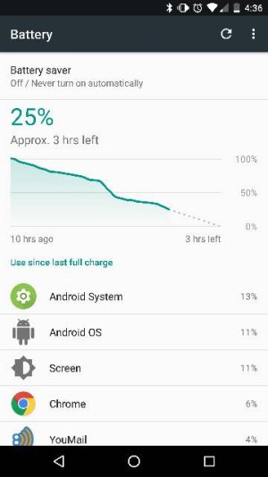

OK here is a photo of the keep awake screen. I have since charged the phone some and it was streaming Bluetooth audio through my car.
Does keep awake include the time the screen is on, or is it specifically time the screen is off that the phone is still working?
If there happens to be a Rouge app, how could I determine the culprit?

To the best of my knowledge, if there is a problem app and you do not know what it is, you'll have to uninstall your apps one at a time and see with each deletion if your battery capacity has gotten better.
This is a tedious process, I know, but by proceas of elimination, you should be able to find your culprit.
It's clear from that screenshot that something is keeping your device awake. You'll have to do some further investigation to determine what.
Along with that your cellular signal is horrible and that will kill a battery like nothing else. For that issue I'd suggest putting the device in Airplane mode if you know you're going to be in an area where your signal is always troublesome. You could use Hangouts and the Hangouts Dialer to make outgoing calls on WiFi; no real solution for incoming calls.
Note that in the History details screen you should normally expect Awake time to closely mirror Screen on time (as shown).
If it doesn't then you need to find out what's causing the disparity. A tool like GSam Battery Monitor Pro https://forums.androidcentral.com/e...etails?id=com.gsamlabs.bbm.pro&token=vCM10N_w (there's also a free version) will help you to get to the root cause.
OK cool. I've downloaded the battery app last night and I found an app that was refreshing mail or some notification sync every 15 minutes in the background... May not have been it, but it's worth a try.
