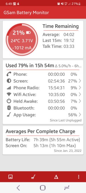

I guess its app usage thats draining the battery

Can you show us the breakdown of apps?
Also, your cell signal is pretty weak in that screenshot, so if it's often like that, it can contribute to battery drain (which may be represented by the 9% Phone Radio consumption. As a test, you could try turning on Airplane Mode, then turning wi-fi back on (which should still let you make and receive calls via Wi-fi Calling), and seeing how the battery is for the day.

I can't show a break down its not accepting the permissions.
it says to connect to a computer.
Yes my signal for the most part is fairly weak.
I only have Wi-Fi calling at work

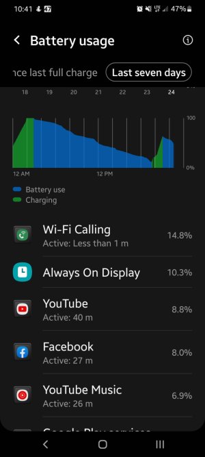

I don't know why the AOD uses so much battery
AOD will always use more battery, since it's keeping the screen awake. If it's not crucial for you, I'd turn it off.
I'm not sure why Wi-fi Calling is using that much battery. Do you have good wi-fi coverage throughout your house? If the phone is often in an area of weak wi-fi coverage, that might be a reason.
