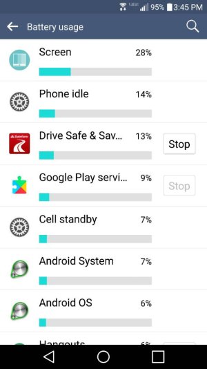

So I just picked up my V10 and battery life seems to disappear right before my eyes. Please tell me this gets better.......
Would you be able to post stats? That would help some to troubleshoot.
