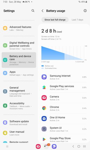

Hi there - I have a new Tab S7 lite, and I am at a loss as to what would explain this (greater than 50%) battery loss in 48 hours with NO USE??
You can see that it has not been used over this time (smooth degradation from start to finish) and only 0.8% has been used by the app with the highest burn? How?
Any ideas?

Welcome.
Devices tend to mutter to themselves if there is a data connection, refreshing things in the background or syncing this and that.
Does the battery seem okay in normal use?

Your getting notifications in background as you see in your status bar so thing's are working but looking at your battery stats you have nothing to worry about .

Android tablets do not have the longevity in standby that an iPad has. It seems to do a lot more in the background. 2 days with minimal use seems pretty good to me for an android device.

I'm assuming the OP is using a Tab A7 lite, since there is no "Tab S7 lite." The A7 lite has a 5100 mAh battery, compared to the S7's 8000 mAh battery, so keep in mind that it has a smaller battery than its big brother.
I also have a Tab A7 lite, and the battery menu estimates about 4 days of standby for me as well. The official specs claim "up to 15 days of standby", but this is almost certainly dependent on turning on all of the power-saver modes.
