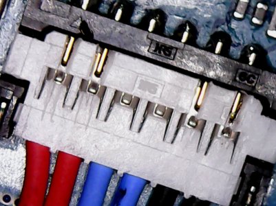

The battery connector already got rework but this picture shows pins of battery connectors don't make good contact, you still have problem of charging or quick discharge.

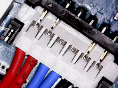

This is the one with good contact

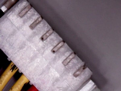

I use silver conductive glue to fix this problem. Use it with care, wipe off any excess glue between terminals with alcohol, otherwise you'll have overheat problem due to short circuit.
