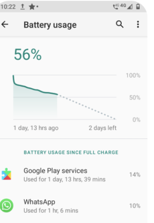

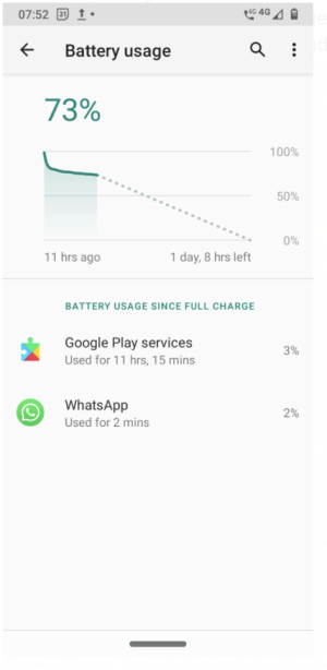

I gave up and thought that high 90s would be OK. But then I noticed that the charge was dropping VERY steeply to the low 80s in about an hour! It indicated that the battery would only last 7 or so hours, but then it leveled out and started indicating more than a day!Screenshot 2023-05-25 at 10.10.01.pngScreenshot 2023-05-25 at 10.38.42.png
Operating time seems to increase over the course of the couple of days after a charge and I am totally confused! I don't trust the phone any more and I am wondering if I'm just going to throw away money, time andd energy replacing the battery again for what seems to be a duff one. I know that LiPo batteries degrade with storage and am now wondering if it's not a better idea to replace the phone?
