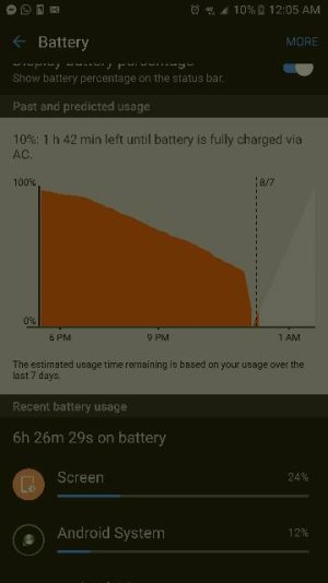

Kelly is getting to the same thing in the post above. I see that Screen is 68% out of the battery % used since off charger. What is the brightness level? I leave mine on "Auto brightness".

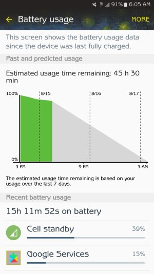

The battery life on my Note 5 has always been bad if I used the stock OS. Once I rooted the phone and loaded a custom ROM onto it, my battery life has been outstanding. I bought my Note 5 in December. Here is a screenshot of my latest battery stats. I haven't used the phone much because I also have two S7 Edge phones and I've been using them for the most part the last two days.
The few times I tired to go back to the stock OS, my battery would barely last me 8 hours. I even tried restoring the phone and without even loading any of my own apps and just leaving the phone alone at home where I couldn't use it, the battery would last eight hours.
The ROM I am using has no preloaded apps. Other than that, it is stock and I am running Adaway on it to block ads.
