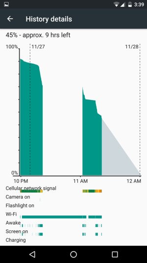

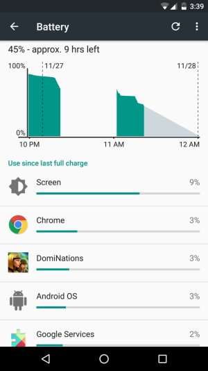

Can you show us some screenshots of your battery stats, specifically including the overnight period? Show us:
1. The main Settings>Battery screen.
2. The fullscreen battery graph screen (which shows Awake time and Cell Signal Strength).
3. The Cell Standby category, if present (to see Time Without Signal).
http://forums.androidcentral.com/am...ide-how-post-screenshots-android-central.html

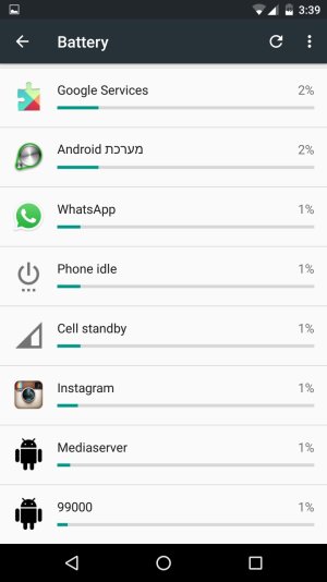

The blank white spot is because i closed the phone during the night.. Thinking maybe he needs some "rest".. :\
What is this black android bty? MediaServer and 99000???
Do you have Bluetooth active? If you do try it without.
It'd be more helpful to keep the phone on overnight, so we can better see anything that might be causing the drain.
Media Server is a system app that's related to music or video file access. I'm not sure exactly what its functions are, but I know that if there's a corrupt media file somewhere, Media Server can work overtime and use more battery (probably because the Media Scanner is trying to scan that file over and over again). Your Media Server usage looks normal. I'm not sure what the 99000 app is, but I have seen various system apps with different numbers pop up from time to time. 1% usage doesn't make me worry too much.
