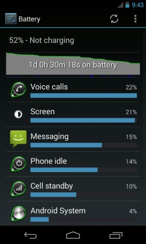

You have to have some kind of rouge all running. My battery had been brilliant since the update. Especially on my N4... check it.
Sent from my Nexus 4 using Tapatalk 4 Beta
Can you compare your 4 to gtt1's 7 ? Apples and oranges ?

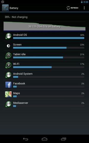

Of course I can. The N7 & N4 are running essentially the exact same software, outside of some minor differences of course. Here is a screen shot of my N7 (2012) post 4.3uploadfromtaptalk1375488740738.jpg
Sent from my Nexus 7 using Tapatalk 4 Beta
Of course I can. The N7 & N4 are running essentially the exact same software, outside of some minor differences of course. Here is a screen shot of my N7 (2012) post 4.3View attachment 75532

Android OS is more than the screen-on time, and tablet idle is almost as much. It looks like you've barely used your Nexus 7 in the past 3 days. I can easily get battery life like that if I just let it sit there.

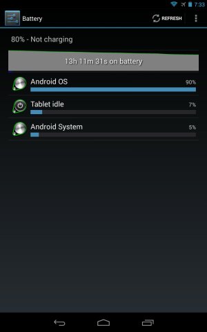

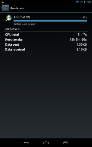

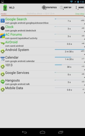

I would add that I see something similar . after full charge and idling tablet didn't sleep at all, draining battery. But I would say the culprit was some app I ran before charging. Suspecting USA Today or BBC News. If I restart it, everything should be back to normal.
But I suspect it happened before with 4.2.2. May be now it's more prominent.
BTW, don't see this happening on my N4... For N4 the standby time greatly improved after 4.3 update.
Sent from my Nexus 7 using AC Forums mobile app
Update; Just restart didn't help. I disabled Google search, stopped running service and restarted again. Now it helped.
Interesting observation (by Eaton Scrapple) about the launcher behaviour. Need to watch it... Strange, though...
