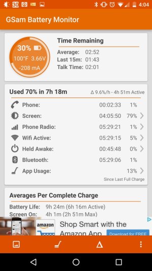

I've spent hours researching this issue online, but haven't found a clear and accurate response. Here's the deal: I have a Nexus 6p with Marshmallow and a 3450mah battery.
I cannot for the life of me understand the stats in the Android battery settings, particularly when compared to gsam. I've attached photos of my gsam, Android battery settings usage, and screen time usage. These were all taken simultaneously for comparison purposes.
As you can see, per gsam, I had the screen on for 4hrs and 5 mins, which as you'd expect, would eat a ton of battery. In fact, it took up 79% of the 70% of battery that I'd used up to that point (note: phone still had 30% charge remaining). Doing the math, .79 * 70, means that, draining from 100 with 30 left, 55 came from the screen. Sounds right.
Okay, cut to the Android Battery stats. First off, it says the screen represents 12% of the battery drain. And sure enough, when I click on the "screen" descriptor, it shows that the screen has used 424 mah. The battery is 3450 mah. 424/3450=~12%
This makes no sense. I had the screen on for 4 hours and it only accounted for 12% drain. What's more confusing is that all the listed items on the battery screen don't come close to adding up to 100%. I understand this changed at some point in Lollipop, I believe. But again, I have no idea what these numbers reflect now. What in the world is 12% supposed to represent?
I'm asking because, first, I want to understand, but second, I returned a s7e because of the well documented high android system drain listed under Android Battery Settings. I'm starting to question whether that's even a real issue since these stats seem meaningless compared to reality. There is zero chance that my screen only used 12% of the battery (or 12% of 70?). Just using simple logic, GSams output seems more appropriate.
So I know what you're going to say... Use gsam. Yes, but, I want to understand what the native battery settings actually mean. If it's completely misreporting usage, it means people are making decisions on phones and changes to enhance battery life based on completely worthless information.
Please help! Not knowing is eating at me.
