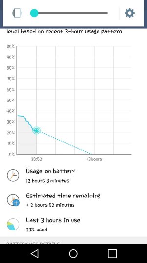

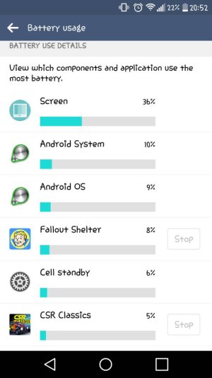

Just like the G3 I had before this G4, out of nowhere the battery usage has suddenly doubled. I got this G4 in October and I've always been able to get 2 days usage out of it before recharging. At the end of those two days the remaining battery percentage would be down in the 50's.
When I would recharge the night before, about 8 hours later on the next morning I would check the phone and the remaining percentage might be 93% or so. Two mornings ago after a recharge I checked the phone and the remaining percentage was 71%. At the end of the day when I got home from work the remaining percentage was 30%. And I'm a very light phone user. So something has suddenly decided to start zapping my battery big time. I need help finding the problem.

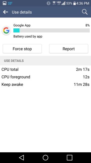

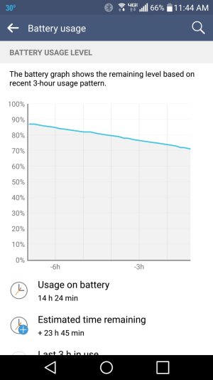

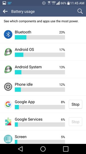

I've included some basic screenshots but if there is something more detailed that you need to see just let me know.
As you can see on the graph that shows the beginning 3 hour period, it really starts to nosedive right after that first three hours and that declining angle is much steeper than I've ever seen before. Since I had the problem with the G3 I've paid attention to those graphs and the G4's usage decline angle has been relatively shallow.

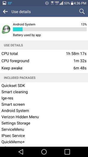

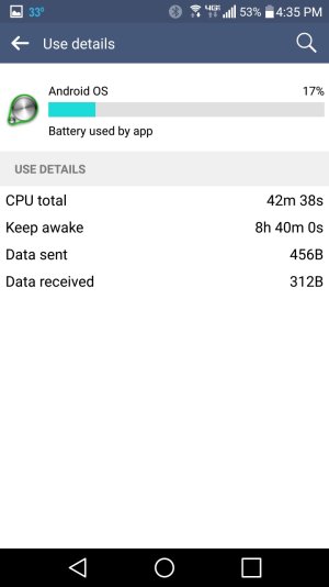

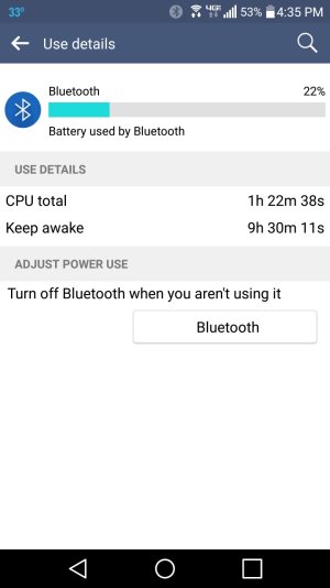

Can you click on Bluetooth, Android OS, Android System and Google app and post those screens as well?

You have an App wakelocking your phone, and it's probably an App that uses Bluetooth. Can you think if anything new you've installed recently?
re:
No I haven't installed anything since I got this phone 4 months ago. The apps I have are old and from when I had the LG G3.

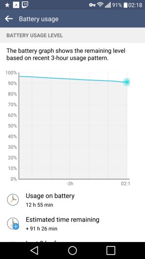

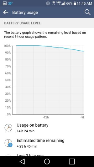

I always thought that type of drain was normal for lollipop. Since day one and during the LG G4 test drive, my normal drain has typically been 2-3% per hour. With the new Marshmallow update my LG G4 battery life looks more like this.Screenshot_2016-02-14-02-13-42.jpg Screenshot_2016-02-14-02-18-49.jpg
If it is possible to wait for marshmallow it might solve your problems. Although I have had some buggy app problems causing wakelocks, I have had to restart my phone in safe mode and uninstall some apps. Try restarting the phone in safe mode.

Have you pair your phone's bluetooth to a new device in the house? Like a new bluetooth speaker or Amazon Echo or something like that? I would also try rebooting the phone if you haven't. Maybe the bluetooth somehow stuck on and searching or something.

I would click that button to turn off bluetooth when not in use.
The only time bluetooth is necessary for me is when I'm in the car which is not that often. I have turned it off through the main settings. But if I turn it back on then hit that turn off when not in use button, does that mean that I get in my car it will automatically turn it on and then off again when I leave my car?

It seems totally wrong that Bluetooth would be the largest battery consumer on your device at 20%+. I have always left Bluetooth enabled on all recent devices (Nexus 4, 5, 6, and now 6P) with actual connected time averaging about 90 minutes per day and Bluetooth never rises above the 1% or 2% mark on the battery usage list.
Something is not right...

I agree. Something is definitely not right. I've always left Bluetooth enabled too. I charged it last Wednesday night at about 10PM, woke up the next morning at 5:30 and checked it and it had dropped down into the 70's remaining percentage and it's never done that before.
I've turned off Bluetooth and the battery has returned to draining at a normal level. I just have to remember to turn it back on whenever I get in my car.

The only thing I can suggest is to open Bluetooth settings and delete all paired devices and then re-pair only those devices you actually use.
