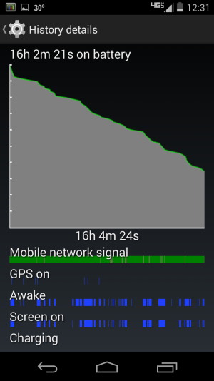

I agree. I have everything possible turned on except BT and WiFi, which I don't use...see my pic below.
I think the most critical thing for decent battery life is to have a reliable, strong signal and if the signal isn't there for your carrier and no other carrier is a viable choice, then do what you can to plug in whenever possible. I charge overnight, every night to start at 100% each day.
