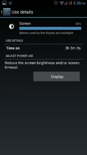

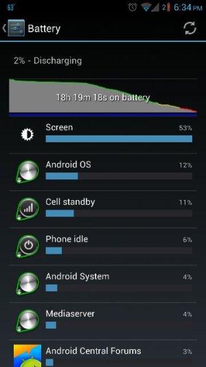

Just did thanks.....battery life is improved a good amount. I'm at 15 percent left with almost 17 hours and 3 on screen...better then the 8 hours I was getting on stock CM kernel

Honestly so grateful for this kernel and ROM combo can't thank these devs enough! Check it out!
