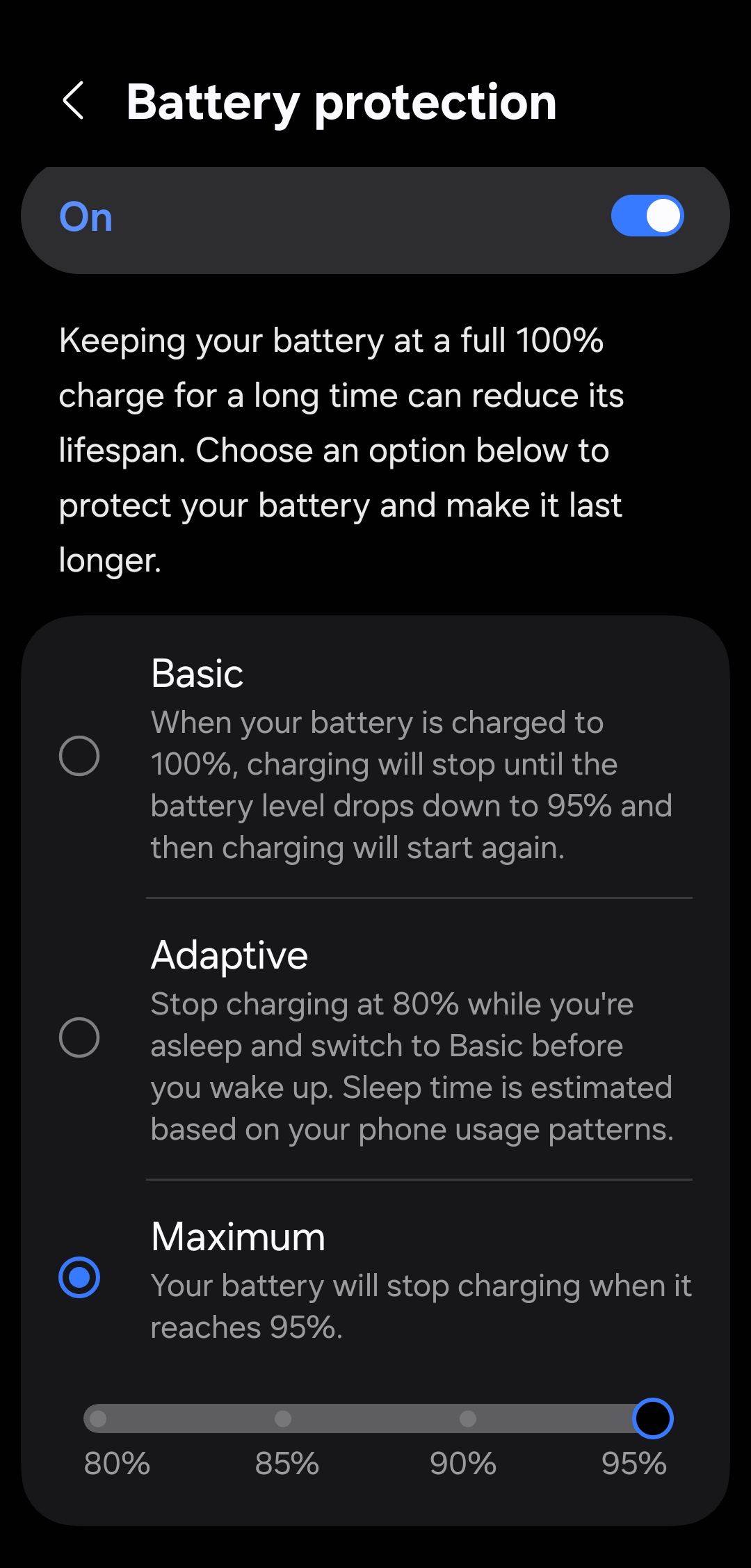

I would like the pixels to add 90/95 cutoff like Samsung and iPhones

Where's the setting on Samsung phones for 90/95 cut-off? I can arrange for my Samsung to do that, but only via creative use of a routine.
Android 15 one UI 7, my s25u
If you are on 6.1 it's not there
What happens after it stops at 95, if it is left on the charger for several more hours (overnight, for example)?

The basic setting seems to say it will charge to a target of 100, then have to drop to 95 before it would try to do a top up for kinda trying to maintain the target. In an optimum arrangement, I think it would be nice if both target and drop threshold were customizable by the user. For me, I'm basically using a target of 90, and then a drop threshold of 80 (to prevent any attempted top ups).
