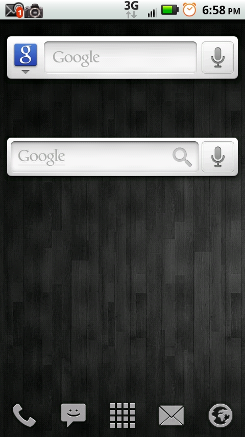

1. Both Launcher Pro and ADW are installing the pre-2.2 google search widget. If you're using either launcher, make sure you don't use it.
The new and correct widget has the blue "G" on the left side. The widget that does not have the blue "G" on the left is the old pre-2.2 widget.

A word about ADW and LauncherPro - They do install the old 2.1 google search widget. When the old widget is used, it can get stuck on a screen. Make sure you use the new 2.2 google search widget (the one with the blue g button on the left of the widget) that was added with this update.
Just one example of how this was not only beneficial, but necessary is the old google search widget. I couldn't get rid of the 2.1 version for nothing. After 2.2 I would see both the old and the new google search widget. The old one, when used, and especially with LauncherPro would get "stuck" and sometimes couldn't even be removed or usable.
My widget list is tiny again and all the extra crap that should not have been there is finally gone. I think this is the very first time I've reset with whatever it was that Moto pushed out.
