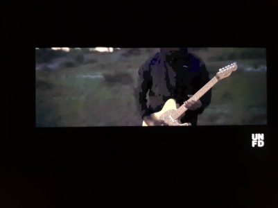

I lose a lot of detail in the clothing and some parts where light colours or lights in the videos meet black or dark areas. Instead of fading into black it's just like squares.
Like I mentioned before it's a fair bit noticeable to me in a pitch black room like in bed at night. Day time or well lit rooms it's pretty good.
I'm using boosted mode , brightness at about 40%, adaptive display on(have tried off helped only a tiny bit)
I see the problem from like 30% and all the way up to 100% brightness (which I don't use).
I have a photo I took with another phone if I can post it up. Kind of shows it.
That artifacting has nothing to do with the hardware.
Yeah I know it's not hardware but was hoping there could be something to fix this. Not a big fan of running colour adjustment apps and whatnot . Comparing the videos with my wife's S8 and the S8 was fine. Blacks were fine.
Like I can live with it if I have to use saturated mode to watch videos. Was just curious.
