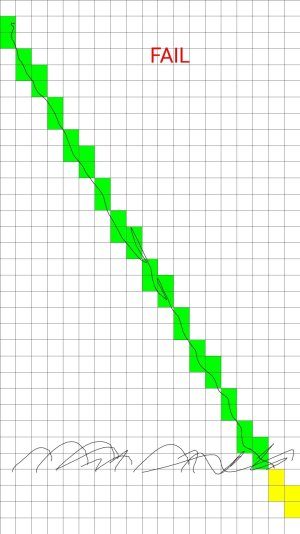

About 3/4" across the bottom of my note 4 doesn't react to s-pen at all, and also, the back button reacts to the pen touch, but the recent apps button does not. I can't see obvious defects on the surface of the screen, neither is the phone in any case, magnetic or not. I did the Wacom Test on the phone and when the diagonal was drawn, the bottom corner tiles did not change color, nor did any line register and the phone returned a big red "FAIL". The whole screen, however, works perfectly with capacitive finger touch. I've done quite a bit of research online, and have found that problems with parts of unresponsive screen actually were caused by magnetic interference with a case. But mine has no case, and the problematic area is quite uniform across the bottom. Does this indicate a problematic phone, or is there a quick fix? Thanks to anyone who can shed some light.

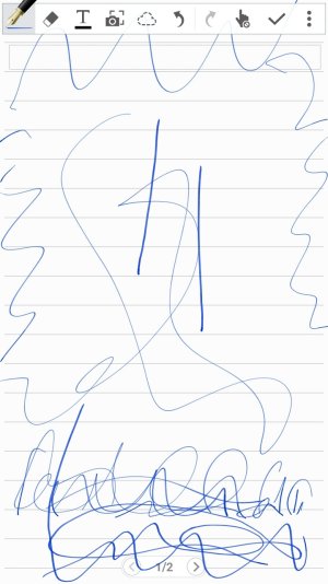

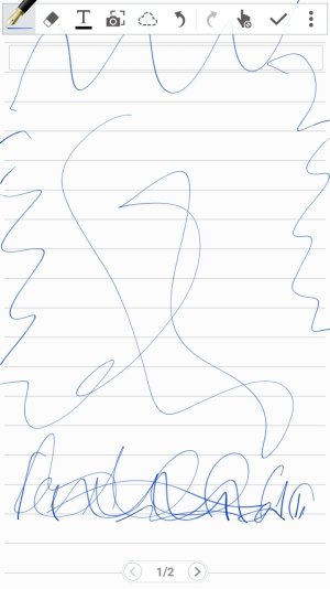

I got in touch with Samsung and they used Smart Tutor to look at the phone remotely but couldn't find a fix. I also have uninstalled all apps I installed, which were only Opera and Phone Info. There's a bunch of AT&T bloatware which I disabled, but I doubt they would have contributed anyway. Here's a screenshot from the phone where you can see the pen doesn't go down: tempFileForShare_2016-09-24-21-44-34.jpg Here's the Wacom Test: tempFileForShare_2016-09-24-21-44-00.jpg
The phone works fine otherwise and I'm getting good battery life, so I'd like to keep it if this is not indicative of hardware issue and has an easy fix (like unistalling an app).
Clarification: the last pic above includes thicker blue lines which were done by my finger to show contrast.
