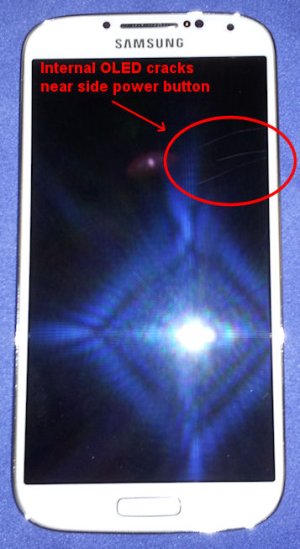

This *EXACT* same thing happened to me.
I have a Samsung Galaxy S 4 (SCH-R970) from U S Cellular that is just over three weeks old.
Never dropped. Not a scratch, dent, ding, chip, etc on it.
Last night I left work and placed my phone face down on the passenger seat of my car. Before pulling out of my parking spot I received a text message, so I picked up the phone to check the message and only a .75 inch wide bar across the top would display. Upon close inspection I saw small cracks in the underlying OLED matrix next to the power button. There were no breaks, cracks, scratches or dents in the glass covering the display. Nothing struck the phone and it did not move on the passenger seat after I set it down. The car was never moved, so it could not have been jostled, bumped, or slid off the seat by the motion of the car. I literally placed it on the seat and picked it up a minute later.
U.S. Cellular and Samsung are both saying that it is physical damage not covered by warranty.
Whether or not it is covered by warranty is not the purpose of my post. There is very clearly an engineering design flaw in the Samsung Galaxy S 4. There is no reason a device should physically break internally with no obvious external forces applied. Samsung made a device with insufficient structural integrity to support the display AND/OR with insufficient separation between the sides of the device and the internal OLED matrix. It is a design flaw.
Samsung needs to reach out to their customers and resolve this issue before it turns into a class action lawsuit.
I'm going to pay the $100 for "insurance" replacement under US Cellular's device protection plan. I mean, what else can I do? I can't even get a different model mobile phone without shelling out the full, non-contract, price. US Cellular offered me a $25 credit on my next bill for my troubles, which is just an insult.

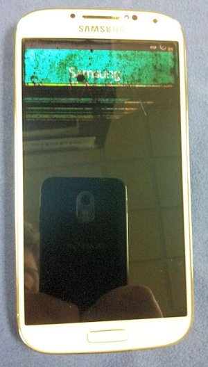

Attached are images of my Galaxy S 4 highlighting the internal cracks and what the display looked like powered on.
The exact same thing happend to my Galaxsy S4 with Verizon. I did not have insurance either. After going to a repair shop, they said it would be $350 to repair, Verizon would replace the phone for up to $299, so I went to the cheaper of the two. Now that I read this, I wish i had gone to Samsung and complained to them.
