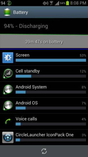

Alrighty update! So i did a bunch of stuff, i did the Google talk thing, and I found out that all of my motion gesture features were on, as well as the Verizon's location service (which apparantly sucks a ton of batt). I also adjusted some push notification settings and voila! I now get around 30mins for 5% of my battery and my battery screen looks like this:
Android System is now using WAY LESS than before! Yay! Thanks guys! :)
