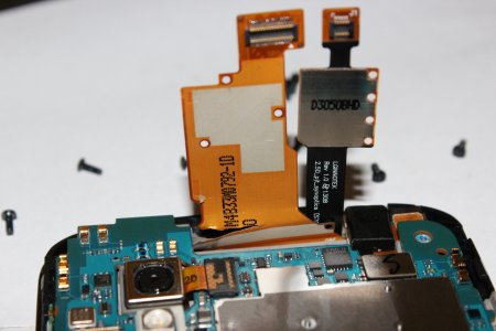

Bought the LCD/Glass/Touchscreen combo for $150.
Everything was going great, had everything in was putting the phone back together. The ribbon that attaches the LCD to the motherboard was being a little troublesome.
I wound up easily ripping the ribbon as if it was a piece of paper. There is apparently no way to fix this, I've searched everywhere. You can't buy a new ribbon anywhere so I'm out of $150 because of that little rip.
It was my nail that cut into the ribbon, why is annoying because I usually keep my fingernails really short and cut them every couple of days. But I hadn't cut them in a few days and that wound up costing my $150...
So don't make the same mistake I did, those ribbons are fragile as ****.
