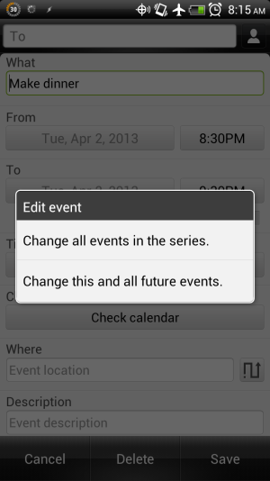

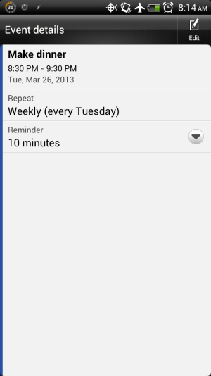

Ah-ha, I think I have figured out what your issue is. While trying to recreate your problem I was able to see all three options when changing a long standing event I've had, but all of my events include addresses and other personal info, so I made up a generic event to screen shot and include in this post. What I found is if the first instance of the event hasn't happened, meaning if you make an event and immediately go in to edit one of the future occurrences it only gives you two options as you see below. However for any event I've set up that I has at least one occurrence that has past I get all three options. I went calendar month view>day of the event>the event>edit. You can try going back a day/week/month whatever and make an event there and see if it will then allow you to edit single events. I did not try this, but if Google calendar will allow you to make post dated events this should work, and allow you to edit as you're asking.

For some reason, when I get to the second screen you showed me, the only option available is "Change all events in the series". I don't even get the second option of "Change this and all future events". This happens even when many instances of a series have already passed -- does it make a difference how (or whether) you dismiss the first occurrence in the series?
Maybe your app is a little buggy because I went in to look around and see if there was something I missed or some difference that would result in what you're saying. I found two things. One my first occurrence its the 26th in the screen shot, next Tuesday because I didn't try to post date an event. When I try to edit that one I get the two options down in the second screen shot, but when I go out to the 2nd of next month, the second event, I get all three options that I described in my post. Just for s&g try going out, if you haven't our aren't, two or three events from the upcoming one and see what options that gives you. I don't know what difference it could possibly make but I get distant options when it seems like regardless one should get all the of those options regardless of when a repeating event occurs that one would want to edit. . Then post back. If it's fixable hopefully we'll figure out something.
