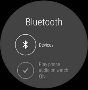

It takes a few extra steps in order to configure the watch be able to dial or answer calls from BT all thanks to the addition of worthless NumberSync feature:
1. Deactivate NumberSync
2. Enable 'Allow phone audio' on watch BT settings.
3. Make sure the phone now can recognize your watch as BT headset and connect to it as BT headset.
Once #3 is confirmed, you will be able to answer or dial calls using BT.

Settings app on the watch. If you didn't see the Enable phone audio checkbox or not clickable, you haven't deactivated NumberSync yet. Just disable NumberSync or turn off cell radio won't help.

I don't see "allow phone audio on watch BT settings. On my watch I have only 3 options under the bt setting: connected or disconnected; scan for nearby devices; and unpair devices. Btw, I'm on AT&T. Any advice?
I don't see "allow phone audio on watch BT settings. On my watch I have only 3 options under the bt setting: connected or disconnected; scan for nearby devices; and unpair devices. Any advice?
You went a level too deep.
I'm confused. When I first go to the bluetooth setting the only option I have is "devices".
Thanks. Got it working now. Last setting under cellular was sharing. I unselected share for both phone and text. Then BT had option to select enable phone audio. Now I'm receiving calls and texts while paired to phone. Thanks all!!
