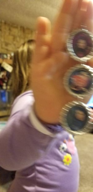

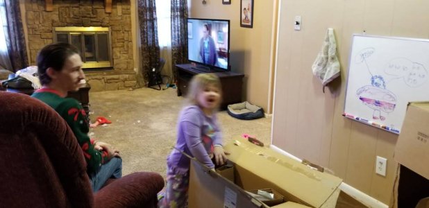

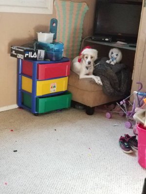

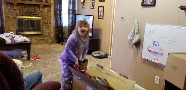

I've been getting a lot of blurry pictures that I didn't get with the note 5. Don't think in doing anything differently. I feel it was a better camera as well. Maybe it's something I'm doing wrong?
Post up a few examples so we can maybe figure out what’s going on.
The last one of the pup is more grainy, than blurry. This doesn't happen all the time by any means, but much more than the 5 ever did

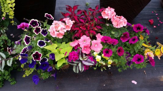

That may be true, but 16M isn't that high. I always get a Galaxy because the pictures and the M was better and higher. I don't understand why they couldn't have the 16M on the Note. Maybe they had to have the 2 cameras the same number? ( 12M and 12M). I take most of my pictures outside so I want the best resolution. I haven't done outside pics yet because it is 0 out right now. But I can tell the clarity isn't the same. I attached (if this works) pictures I took this summer with my S5, and you can zoom in completely and the plant's leaves are crystal clear. I just want Samy to know that taking crystal clear pictures is a high priority for their customers. I would like the next Note to come with a 16M camera for sure.

those look terrible, almost as bad as my LG L90, ($50 new). could you try clearing the cache? Have you changed any settings? You might have to do a factory reset. if that doesn't work you might consider taking it back.
Well with indoor lighting no smartphone camera does well with moving subjects. And the pic of the pup should definitely look better than that.

The motion blur is due to a relatively long shutter speed. Notice how the background is still blur free and it's only your daughter that is blurred due to her moving. So next time try manual mode and experiment with a faster shutter and perhaps higher ISO if needed.
The one of the dogs looks like high ISO noise. Since they aren't moving fast, I would suggest a lower ISO and higher shutter speed.
It's a balance between ISO and shutter speed, and changing one can affect multiple aspects of the image. I.e. A longer shutter speed gives a brighter image at the expense of motion blur. If you try these in auto mode, different cameras will give different results. One app programmer may prefer to increase ISO in a dark setting, but another developer may increase the shutter speed. They do what they think is best, but it may not be the best for your tastes.

I've never done a thing other than auto on both phones, guess I'll have to give it a try
Auto mode is like ordering at different restaurants. You could order the same meal at each, but they won't taste exactly the same. Each chef will have their own little twists to how they create the meal.
Shooting in manual mode is like preparing that same meal at home. It takes practice, but eventually you start to develop your own style. Coincidently, I use a similar comparison when deciding if you should save as jpeg or RAW. If you don't want to deal with editing, then save as jpegs. If you save as RAW, then you will have to edit and convert to jpeg with a special program.
