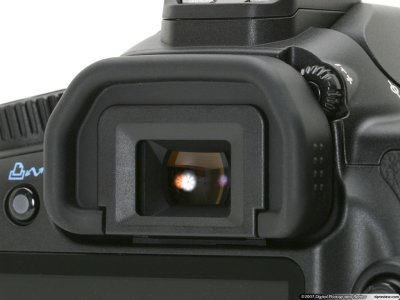

I'm confused; what viewfinder? Do you mean the display? The display (6.3" I believe) is what you view the proposed photo and the photo once taken usually goes to the gallery or photo folder (depending on what you are using for viewing photos).
Possibly it is my years of using SLRs/DSLRs that when the term viewfinder is used; this is what visualize....
I'm speaking about what you see in the camera app before taking the picture
