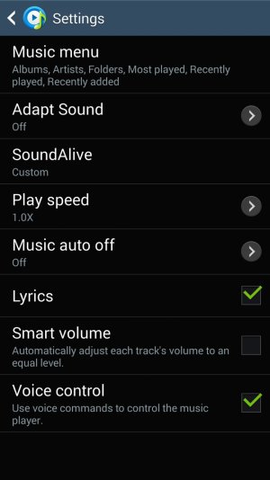

Next (track forward), Play, Stop, Volume up, Volume down, etc. Music/settings check box to allow voice control.
Mine used to work. Maybe a software glitch.

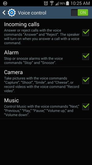

Don't worry about these "ambassadors" who know better than everyone else, Pete. I use Voice Control with the stock music app, and have since I got my S3 (and now with my Note 3).
Anyway - it could be that your S-Voice app needs you to clear Cache/Data in App Info. Something is showing the settings as "set" (like my screenshot), yet they aren't working. And you can eliminate it being a mic problem or fuzz in the mic hole since "ok Google" and other S-Voice functions seem to work. Note that there is one other thing that could cause this - you may have already checked "do not show this again" - when you turn on Voice Control, it says, "If you set the alert type for calls or alarms to vibration, voice command is not available." - so it could be that you have some alert set to vibrate which could cause some of the settings to turn off internally.
