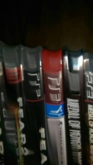

My camera has been having the same issue since the begining of summer. I mounted it to my motorcycle handlebars and ever since close up pictures are wavey and intelligible.
Not only is the camera buzzing, but as you can tell, takes less than fuzzy pictures. Please help.
