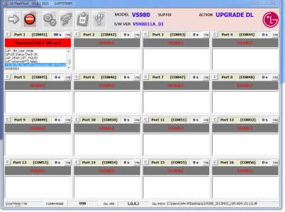

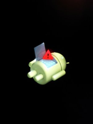

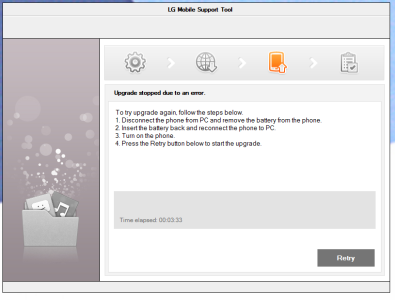

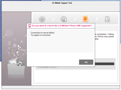

I am having a hell of a time with my phone (VS980). The only changes I have done are root the phone and the hotspot mod. I did both of these about a year ago. After the hot spot mod I have not been able to update the phone, OTAs fail, but other than that the phone has worked fine. Yesterday morning the phone froze and restarted itself. Now it just stays on the LG screen not matter what I do.
I have tried to do a factory data reset by holding down the - volume and the power button and once again when the LG screen pops up but it either freezes or I get the android with a red exclamation point. I am able to access the download mode but both the TOT and KDZ method do not work. Attached are the screenshots for the problems that I am having with the factory data reset, TOT method, and KDZ method. I am not sure where to go from here... I would appreciate any advice you guys may have.

Did you update USB drivers? And why are you using LG support tool?
Sent from my G2 running PAC-man
Re: "Bricked" Phone - Here is what I've tried... SCREENSHOTS included
I am using the "USB Driver for Windows" VS980 that I found on LG's website. When I tried the KDZ method I used the LG flash tool 2014 and while going through that process the LG support tool pops up.
Edit* I think the LG flash tool 2014 and the LG support tool may be one in the same thing. Not sure though.
Yeah, you don't need LG support tool if you're using LG flash tool. Whenever I had issues unbricking a G2 I uninstalled LG USB drivers, and then installed most recent LG united mobile drivers and universal adb drivers, then everything worked fine.
What instructions/guide are you using? XDA has the most detailed instructions.

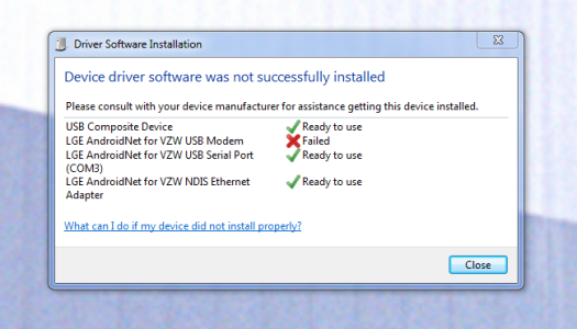

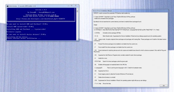

Alright, with the LG Verizon United Driver I have a problem where it fails to install the LGE AndroidNet for VZW USB Modem. I uninstalled the LG united driver and then tried the ADB installer and received the following error which you can see in the attached images.

I was finally able to get the TOT method working by using my laptop instead of my desktop. My desktop OS is Windows 7 -64bit and my laptop is Windows 8.1 -64bit.
