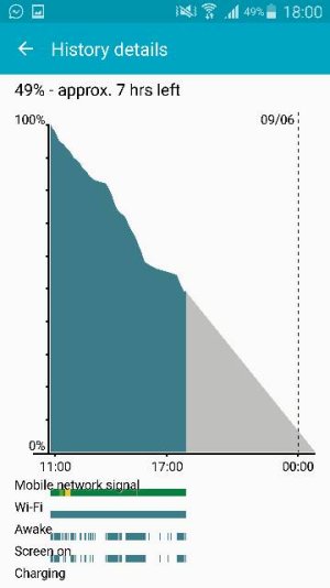

I bought note 4(nm-910c) 4 days back and I also updated to lollipop.
But I'm not experiencing a great battery life.
I had to switch mobile network to 2G(gsm)only and power saving to see my battery drain to 50% in 4/5 hours with only WhatsApp used in Wi-Fi. I can post the battery usage screenshot here.
Is this normal?
This is with 2G network, power saving and brightness kept at least.
What is your screen-on time, and screen brightness?
Must do a hard reset for batttery life to come back after updating to lolipop. Use Samsung Kies online to keep your files while doing hard reset.
I dont necessarily think this is bad battery life. The OP says just 4 to 5 hours of use but the battery chart covers 11:00 to 18:00 so that's 7 hours . . Just a guess but it looks like 3 hours of SOT if not more based on the SOT graph. When screen isn't on the battery curve is fairly flat and the device appears to deep sleep (looking at the 15:00 to 17:30 range).

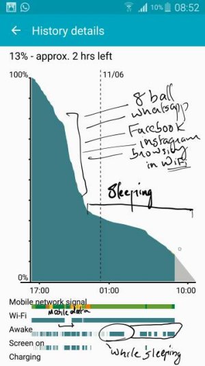

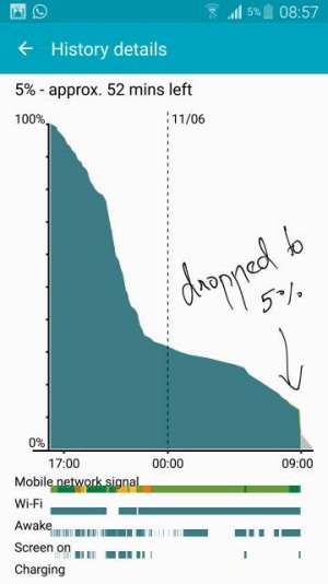

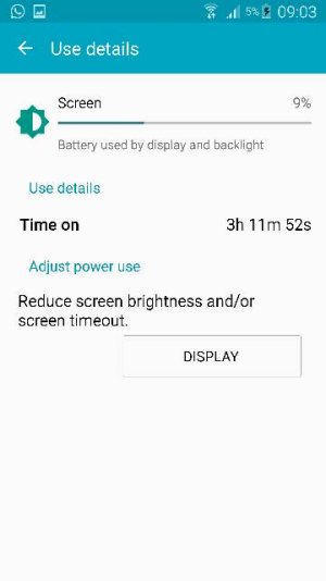

In 3g always...WiFi is on..location is off..
No power saving too

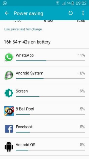

Battery usage

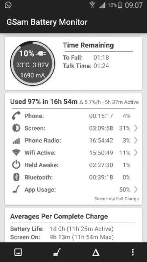

Screen time
That wake time with screen off is a concern. Like I noted above clear cache in recovery and do a clean boot. It's best to test on clean boot without ever launching anything, wait a couple of hours and then check battery stats to see what floats to the top.

I'd say for adnanrider, you're getting a full 24 hours battery life with almost half of that being active usage, and over nine hours screen time according to the GSAM screenshot. In my view, thats quite good.
