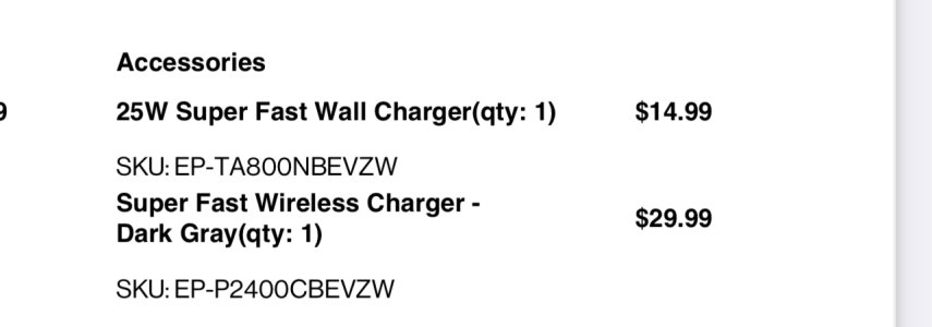

I appreciate the quick response. I’ll be back at Verizon to return it and get the 25w Samsung branded charger. Can you recommend a wireless charging pad that Samsung makes for this phone that Verizon sells; please.
Re: Samsung 45w wall charger with z fold4
This is what I bought. Acceptable?
