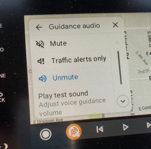

I was wrong in my earlier post. I've just looked at it again and there are mute functions but it is not muted and guidance audio is turned up to the max.20210422_092336.jpg

I solved the problem today. If you look at the screenshot of the Navigation Settings that I posted earlier you see that by default the "play voice over Bluetooth" is turned on. Since the phone has to be connected by a cable to use AA, I thought it could be the issue. I turned that off and now I get the audio directions.
