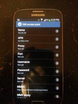

I've been through this issue for months now. I finally had it solved today from talking with telus support.
Here is a screenshot of my TELUS SP settings on my S4, type SGH-I337M running Android 4.2.2
The key field for me was clearing the text in the APN type, make sure that field is blank.
