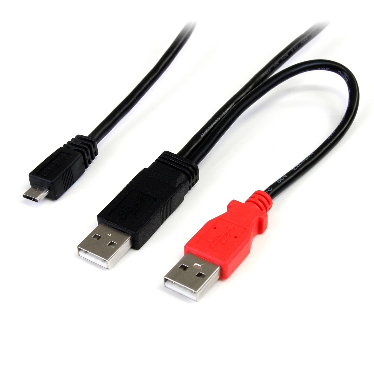

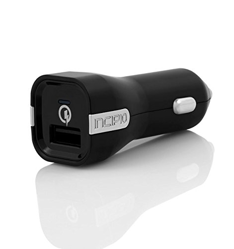

My car is equipped with MirrorLink and all of my apps work while in motion. So I want to use a nav app but it drains the battery faster than my car's USB can provide. I was thinking of buying this which is Qualcomm quick charge approved
and this:
However, the red USB is charge only with no data transfer. I understand that I need data to tell the charger that my phone is quick charge capable. Correct? And I would guess that I would also need data for my phone to MirrorLink with my car? If that's the case, I guess I could just use an external battery charger instead of the 12V one. That brings me to the question is if I could safely be giving my phone 2 power sources (the car USB and the external battery or 12V charger). Any help would be appreciated. Thanks.
