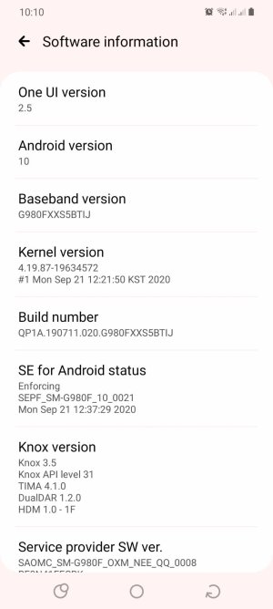

jesper0120
May 15, 2024
4
3
3
Visit site
@Laura Knotek
Please see the attached picture for details about which software version my phone has. If I recall I have ONLY installed one software update, and that was some days ago. And I purchased the phone in August 2020 I believe.

joeldf
Dec 19, 2011
1,239
673
113
Visit site
Let's go back a bit here.
Your S20 (I speak phone name, not model number) is still on Android 10? That should have been updating itself to 11, 12 and then finally up to 13 over a year ago. Now, your security updates have been reduced to quarterly releases, but it should still work.
I had an S20 FE, which was a few months newer than the regular S20 at the time, but I'd still be using it if I hadn't shattered the screen late last year. My son is still on an S9 (which is stuck on Android 10 One UI 2.5 - nothing newer for it).
So wholesale obsolescence is not the issue here. Isolated incidences are. It could be something is just failing, but it could be the software is crossed up and needs resetting.
Unless I missed it (and I do miss things a lot), I don't see that you tried a factory reset.
Next is trying to flash at least a more current OS.
Once you get the USB cable issue working. Without that, you may be stuck.
