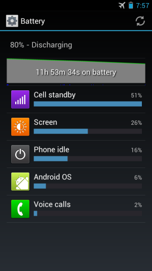

I'm using it on a GSM carrier so it's on global mode but that shouldn't be the case since 4G/LTE uses much more power. battery dropped to 80% in 8 hours without even leaving the screen on for 1 minute. I didn't use the phone in this period. See the photos please.

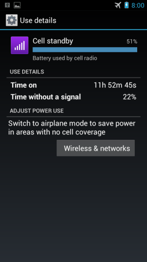

As noted in your pics. You were at 80 percent after almost 12hrs. For essentially 3hrs(roughly, 22 percent) of it, you had no signal. Even though you never made a call, it was trying to find a signal. Did you set the phone to global mode, so it wouldn't try the CDMA?

Your signal seems pretty lousy, which would explain the battery drain--the phone's radio is working overtime to try to find a signal, even if you're not trying to make a call. Is the signal worse at work or at home? I suffer from the same problem where I work, and I routinely switch to Airplane Mode there to prevent battery drain.

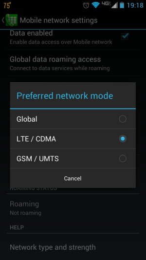

When you mean global mode, have you tried moving to GSM/UTM instead of global?
See pic below
I'm still not sure what the difference between global and GSM really is.
Did you say you have purchased a Sim card from a carrier where you are? I would change to the GSM if you did.

Yup it is set to global mode because I'm using it in Iran which has GSM.
I have yet to try that. I think when you set it to global mode it will be LTE/GSM ready rather than just focusing on one of them.

Why do you say you have great signal most of the time? The fact that 22% of your time on is without signal (according to your battery stats) would suggest otherwise. Be aware that the Maxx's signal bars can fool you--they don't necessarily update until you try to make a phone call or connect to mobile data. So what I've noticed at my work is that the phone will show 2 or 3 signal bars at first, but when I try to make a call, it suddenly plunges to zero. It might be that you think you have great signal because of what the signal bars are telling you, but you actually have none, and you wouldn't know unless you actually tried to make a call in the dead spot.

Yes I was paying attention to those signal bars. but with my other phone I get a good signal. I'm not sure why that 22% is there.

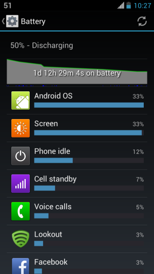

Sorry for the delay--for some reason, the Android Central Forums app wouldn't let me upload it from my phone, so had to transfer it to my computer.

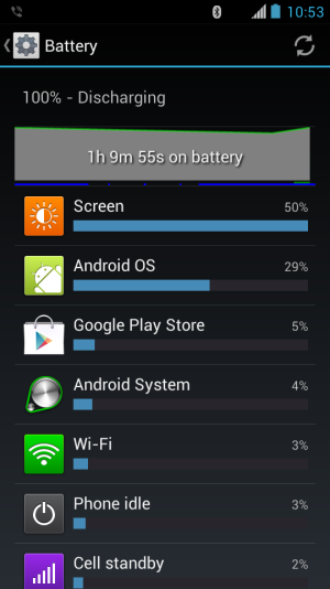

Here's mine for today
It won't let me save images...
Sent from my DROID RAZR using Android Central Forums
Here's mine. I updated it to 4.2.1 and set it to GSM mode. Seems better now.
